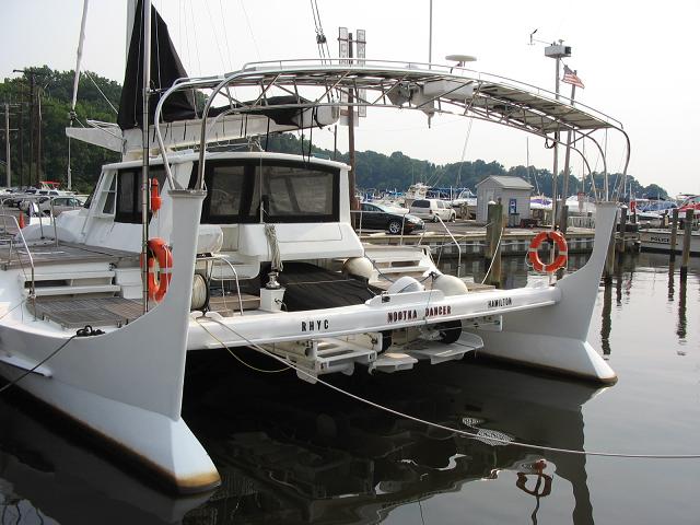

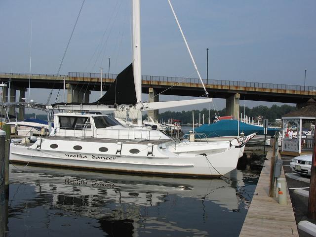

A couple of years ago I spotted this vessel in a marina near Annapolis MD. Just had to take a closer look. And I found a number of unique ideas. These photos have been languishing on my computer unused. So here they are...enjoy:
This was over on a sail maker's website, http://www.ukhalsey.com/newsletter/jan2006/
NOOTKA DANCER was conceived 15 years ago in Hamilton, Ontario, by John and Helen Eisner, when they decided to build a big catamaran based on the catamarans of the native America Indians of the Pacific Northwest. Its unique profile is admired by all who see it.
Three years ago and tons of epoxy later, they finally launched the boat and motor-sailed to south Florida where they finished the project. Several innovations are obvious, the most conspicuous being the Aero Rig. This was the second set of Aero Rig sails UK Halsey Miami built and there are very specific challenges to be met. The leech dimension is very precise with little leeway because there is some mast deflection in spite of the carbon lay-up. Matching this deflection with the luff curve and the leech length leaves little room for error — according to John, we nailed it.
IMG_0561.JPG [ 7.21 KiB | Osservato 4434 volte ]
IMG_0565s.JPG [ 63.71 KiB | Osservato 4434 volte ]
per essere brutto è ben brutto
